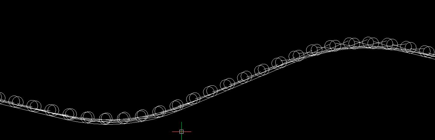

  • May not help but Autoturn draws path lines in 2d for the vehicle edges etc. In Civil Site Design it has a 3d sight checker, which shows obstructions it is normally used for crest checking etc, it has a similar module for driveway checking but it is limtied to a fixed cross section shape ie a car/truck, not a semi which bends in middle.
    I wrote my own vehicle checker which draws the vehicle along a path, you can see where it hits a surface, the secondary option to that would be add just that a second block that takes hitch point and center of rear wheels, ie a semi.
    It has been some time since I used Autoturn so don't know about 3D object support in checking.
    Oh yeah its a visual check which was adequate for us.

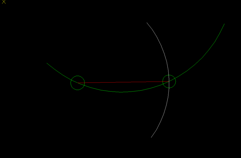

  • The path would be just a long section from a TIN, then walk along the path at a spacing, placing a block that is rotated, as it is placed. hopefully you can see how it works it sets a base block point then gets a 2nd intersection point based on the white arc intersection point. Using these two points a rotation angle is worked out. Then move along and do again.
