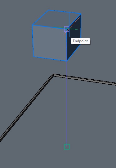

Hello,
I am trying to move a solid (I'm in a BIM project), and when I try to place the base point for the move on the solid, it tracks to the ground. Is there a way to toggle that off?

  • Hello.
    You could check whether OSNAPZ=1.
    If this is the case, set OSNAPZ=0.
