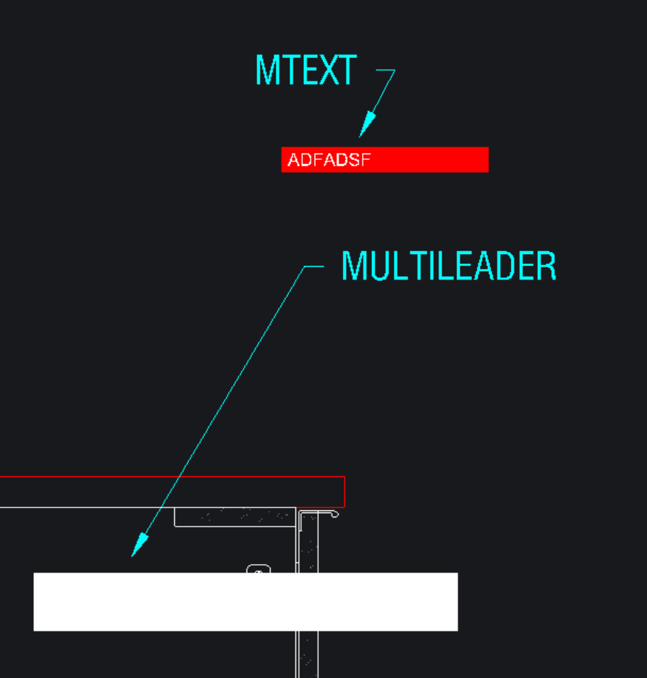

I am attempting to create an AutoLisp routine that will "Create BricsCAD autolisp called “MLM”, for selected text and multileaders, set background mask to yes and set fill color to use drawing background color, and border offset factor to 1.25".
Using Gemini, I'm able to create a lisp that will mask both types, only the fill color is not the drawings background, and the border offset factor doesn't change from 1.5.
Any help? Please.

  • aridzv,
    Thank you for your input. However, I personally do not know how to write lisp code, so I use AI. I do not know where I would add your code in the routine I've already created. Below is the code I created (MS Copilot 365 actually). If you would include your code my code where it belongs, I would be thankful. Attached is an image of what my code does.
