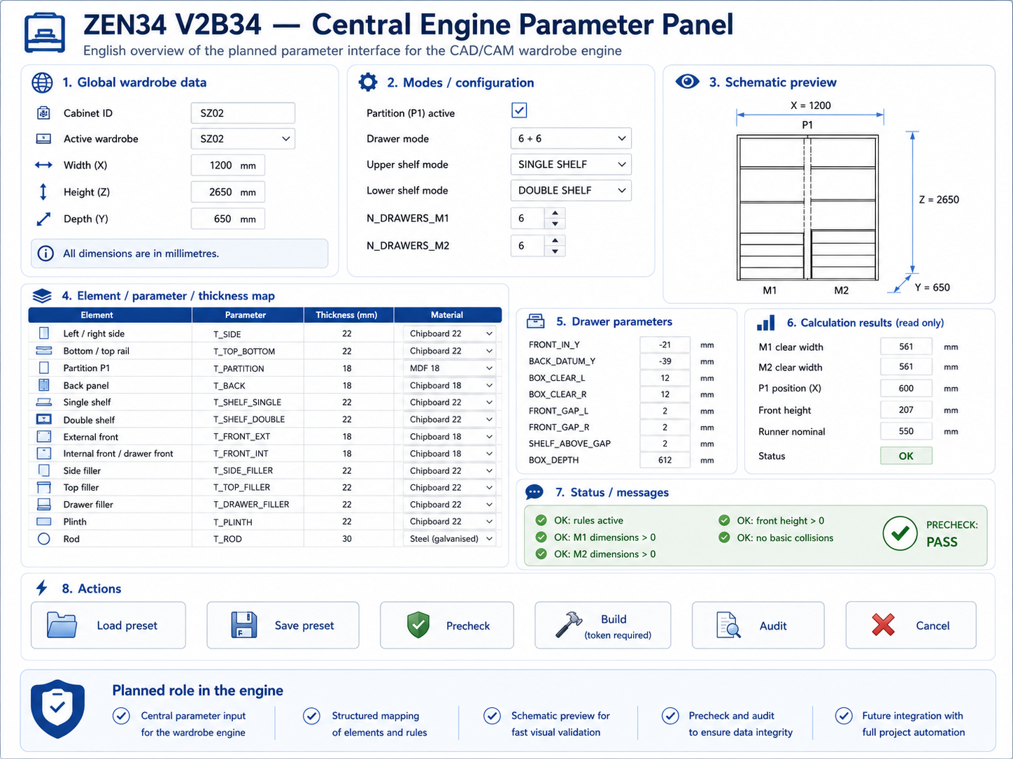

    Single wardrobe parameter table
    Area
    Change
    Mode
    Result
    Cabinet body
    width, height, depth
    manual / preset
    new overall size
    Partition
    on / off
    switch
    M1/M2 or full wardrobe
    Shelves
    quantity, height, type
    automatic / manual
    rebuilt shelf layout
    Double shelves
    on / off
    automatic / manual
    double shelf system
    Drawers
    quantity, front heights
    automatic / manual
    rebuilt drawer package
    Shelf above drawers
    position
    rule-based
    always 30 mm above top drawer
    Rods
    position
    under shelf / manual
    hanging zone
    Filler panels
    on / off, width
    switch / value
    side package update
    Plinth
    on / off, height
    switch / value
    base update
    Thicknesses
    boards, backs, fronts
    mm values
    geometry rebuild
    Runners
    nominal standard
    automatic
    drawer depth adjustment

    Next we will run operator-input tests: the LSP asks for values, the user enters real parameters, and the engine validates the result. This will test manual drawer heights, manual shelf positions, automatic shelves, rods, dimension changes and the locked 30 mm shelf-above-drawers rule.
    After M1/M2 tests, we plan to transfer the same logic to a fresh FULL wardrobe without a partition. Later we want global changes for the whole project and automatic dimensions in layouts, plans and sections.
