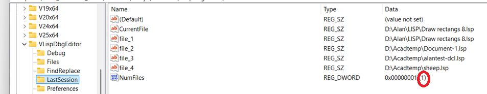

I was thinking the same it is in the registry wether to have a file open or is it blank. it may be as simple as a 0 for blank X for file in list of file names. Like you maybe later have a look.
Found a couple of things in the image the (1) means use File_1. If Blade is blank then its (0).
I am not sure though if just changing the (0) to (1) and set the filename is all you need. Part 2 of that task is using lisp to setenv. Computer\HKEY_CURRENT_USER\Software\Bricsys\BricsCAD\VLispDbgEditor\LastSession, Note Currentfile also.

(vl-registry-write "Computer\\HKEY_CURRENT_USER\\Software\\Bricsys\\BricsCAD\\VLispDbgEditor\\LastSession" "Currentfile" "D:\\Acadtemp\\test2.lsp" )
(vl-registry-write "Computer\\HKEY_CURRENT_USER\\Software\\Bricsys\\BricsCAD\\VLispDbgEditor\\LastSession" "file_1" "D:\\Acadtemp\\test2.lsp" )
(vl-registry-write "Computer\\HKEY_CURRENT_USER\\Software\\Bricsys\\BricsCAD\\VLispDbgEditor\\LastSession" "NumFiles " "0x00000001(1)" )
Its not working as I think it should as I don't have the correct admin rights need to set that, there are permissions in the regedit tried changing them but they did not change. A bit more homework needed and need help setting (1). Manually changed file name ok.

Ok it worked, using the vl-reg I opened blade and opened last lsp used as say file1, when you look at then registry it will have the 0x00000(1) so just change the file1 and currentfile name to be what you want. When you open Blade it should now be correct file. It only works if you set last file number to match.

Jerry I did what you asked had the same file name for file1 and file2 and it worked. Just need to say make sure file1 is always the current file before existing blade. Save do not close files as that will set the Binary flag to (0)

Today I learned that the vl-reg-write command will create a REG_RZ value if you provide a string and it will create a double real REG_DWORD if you provide a number. Therefore when setting numfiles input a 1 instead of a string. That correction made my routine work. Numfiles is the number of files that were open when you closed BLADE and shutdown Bricscad. I believe the values are saved to the registry only after shutdown cad.
So when you restart cad and open BLADE the previous files will be opened. Right now with numfiles set to 1 and my saved file in file_1 just that file appears. Therefore we lost the previous status of BLADE. I will correct this later tomorrow by reading numfile adding 1 and writing my file into file_n. I may have to check to make sure my file is not already in the first n files in the list. Should be straight forward.
Alan, your test with two files with the same name worked because you used numfiles set to 1 so I think the rest of the list is ignored. Thank you for putting so much effort into my project.
