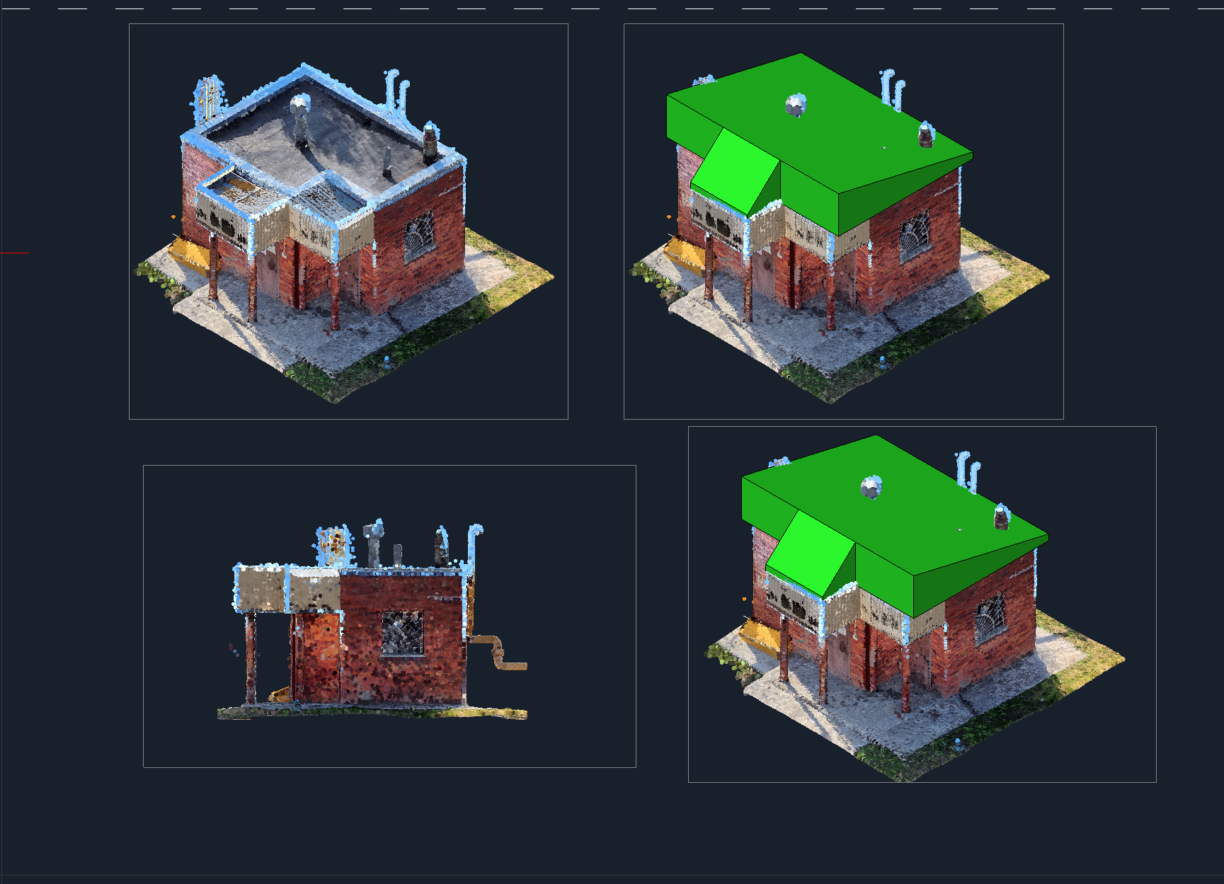

In Bricscad should be:

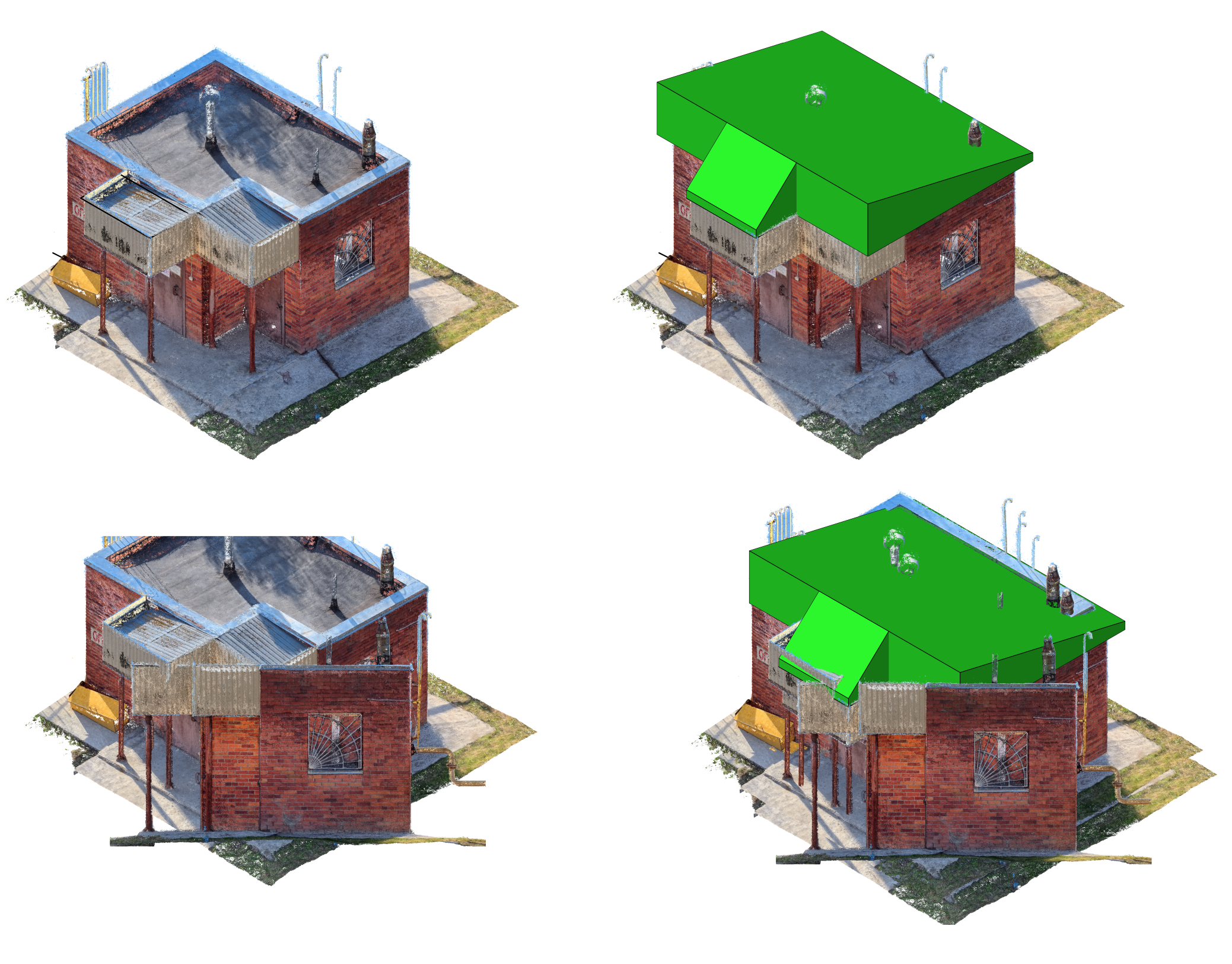

After plot to PDF:
Any ideas? what to do?

  • Does this happen during printing to BricsCAD's Print As PDF.pc3 or to other PDF printers also? You can try Microsoft Print to PDF or PDFCreator.
  • Yes, i used BricsCAD's Print As PDF.pc3.
    Microsoft Print to PDF - same
    PDF-XChange - same
  • Hello Sukovykhap
    This looks like a bug. can you please create a support request so we can further look into this issue?
