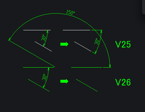

When you grip and move the arc of an angular dimension, the angle changes unintentionally, making it impossible to move the dimension while maintaining its original angle.
This phenomenon does not occur in every instance, but the conditions under which it arises are unknown.
Comments
  • The described issue is not rather clear for me, but I'd suggest to try to change the DROPGEOMMODE variable to 1. It's a new variable, appeared in V26, it controls the geometry dragging.
  • 本件に対しての追伸
    その後もいろいろ試してみました結果、V26 で書いた角度の異なる線分かつ45度以下の角度で角度寸法を書いて、寸法線の円弧及び寸法値をグリップし移動すると件の現象が現れます。
    なぜ以前のバージョン(V25)で書いた線分にはこの現象が起こらないのかは解りません。
  • Thank you for illustration, it's clear now, and I can reproduce the same behavior. Unfortunately, this is a bug in V26.2, it's on correction now.
