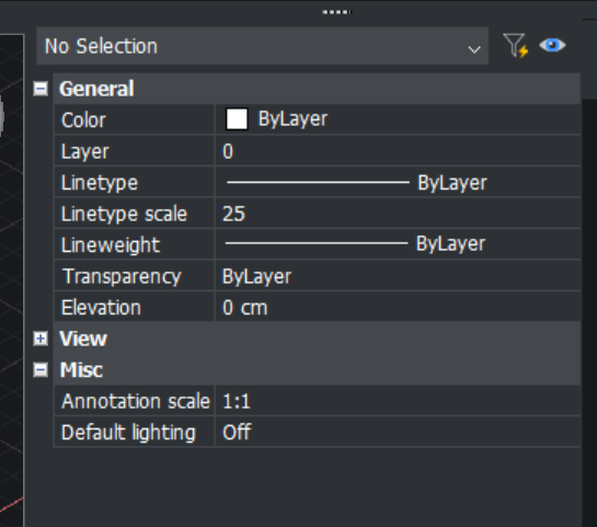

Upon opening a drawing file, the CELTSCALE (linetype scale for newly created objects) will change to match whatever the current DIMSCALE is set to. i.e. if the DIMSCALE was set to 25 when the drawing was closed, the CELTSCALE would be set to 25 upon opening the drawing. Perhaps the weirdest and most frustrating part is that it doesn't happen every time, only about half the time. We typically have our linetype scale set to 1 for all newly created objects, so this can make any dashed lines way bigger than expected.

Does it happen with any drawing or some specific? I don't see at the moment, how DIMSCALE may change CELTSCALE. If you can attach some example drawing, we'll check this on our side.
