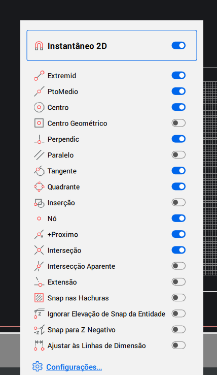

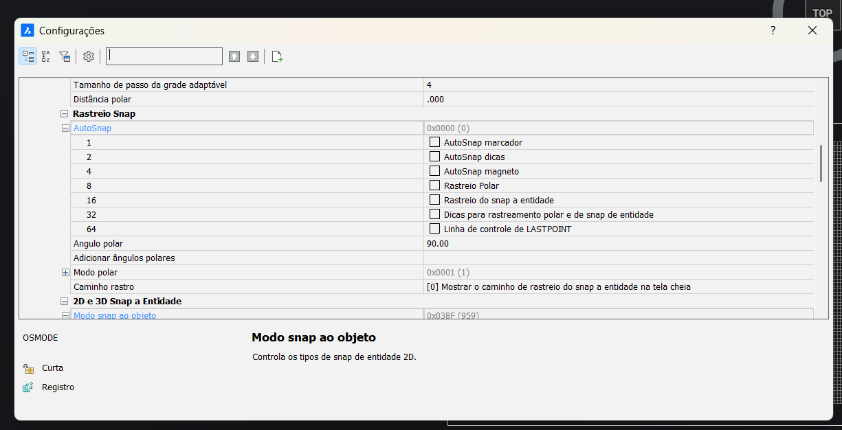

De uma hora para outra o snap parou de funcionar. Vou copiar ou mover e seleciono o objeto, enter, e aí quando coloco o cursor sobre o ponto base da copia não aparece canto, perpendicular, nem nada.
Não mexi em nada, não modifiquei nada, só parou de aparecer! a caixa de diálogo de snap está selecionada, os comandos que uso estão selecionados: extremidade, meio, perpendicular, etc, mas na hora de trabalhar não aparece

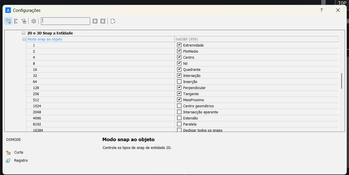

    Nas configurações do SNAP 2D / CONFIGURAÇÕES, em AUTOSNAP aparece ao lado: 0x0000(0), embaixo tem uma lista de números a esquerda e na direita: AutoSnap marcador, autosnap dicas, magneto, polar, rastreio do snap a entidade, dicas de rastreamento polar e a entidade, com quadradinho não sinalizados.

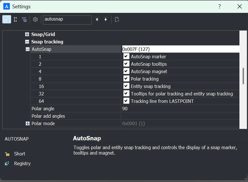

  • When AUTOSNAP is set to 0, no AutoSnap features are enabled, so no snap indicators are displayed. The value shown in parentheses indicates which AutoSnap options are selected; when nothing is selected, no snap feedback will appear.
    By default, AUTOSNAP is set to 127, which means all AutoSnap options are enabled. If you want to restore the default AutoSnap settings, you can create a new profile.
    The snap marker is displayed when the AutoSnap Marker option (the first AutoSnap setting) is enabled. In this case, AUTOSNAP is set to 1.
    Make sure that for OSMODE (Entity Snap Mode) the required object snap options are selected.

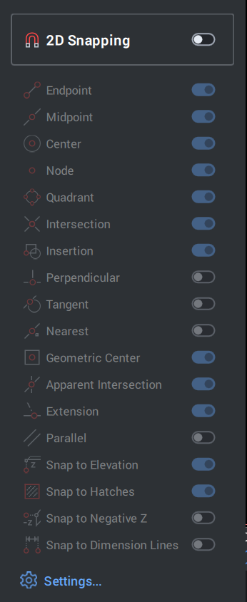

  • It's just a thought, but have you got an Autolisp, .NET, script or add-on that could be turning the snaps off?
    There is also the possibility that you might be hitting F3 on the keyboard by mistake and turning the snaps off.
    The snaps are still showing as on in the pop-up list from the status bar, but are all greyed out.

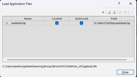

  • We have some Osnap settings in a load on startup, so if snaps are gone just type a command and they are back. One thing you can do in some commands is transparently turn on snaps to what you want. You don't have to match number name just done for convenience.

  • To create a new profile use PROFILEMANAGER command. Here are more details: https://help.bricsys.com/en-us/document/command-reference/p/profilemanager-command?version=V26&id=165079095823
    Now that you have a new profile, AUTOSNAP should be 127, the default value, so all the options should be checked:
    In this case, the snap marker is expected to work because the AutoSnap marker setting is checked.
  • No need to make a profile just have a lisp load on startup. You can set all the variables you want in that lisp. Stuff like UNITS, Osnap, turn off Viewcube and lots more. Even down to registry entries.

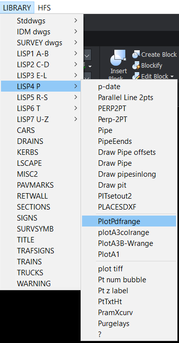

  • This is my Bricscad, type appload. The Autoload.lsp it has 42 lisp defun/commands inside it. Some needed for general CAD use lots of shortcuts.
    And the main POP menu has some 130 lisps behind it. Inside those is set correct osnap depending on task.

    Patricia funcionou!!!!!!!!!!!!!!!!!!!!!!!!!!!!!!!!!!!!!!!!!!!!!!!!!!!!!!!!!!!!!!!!!!!!!
    Obrigada!! apareceu como quando abri assim que comprei, agora teria que personalizar do jeito que eu gosto trabalhar mas tenho medo de perder de novo alguma coisa, se bem que se bagunçar posso criar outro perfil de novo, né?
