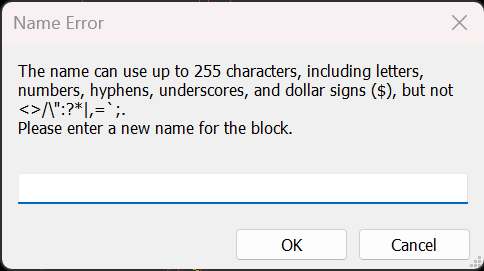

On my menus, I have pull downs for different items I like to import into the drawings. In the last couple of releases for v26, I have noticed them not working as they used too. Here is an example of the Command that is inputted:
^C^C_-insert Valve-01 \;;;
It does pop-up this screen:
I can't seem to find any notes on this. Is there a blog post or forum post explaining how I must go about using certain format in the Command Line? I have searched but seem to be coming up short.

    You could use this.
    ^C^C(command "_-insert" "Valve-01" pause pause pause pause)
    This may be a bug looked at old mnu stuff and matches what you have in Acad.
    ^C^C-INSERT P:/AUTODESK/blocks/NOTES/NOTES-2007 DRAG \1 1 0
  • Thanks, that solved a few command issues. But is there a document that explains this so I can correct all my command macros?
  • ChristopherH
    edited October 21
    Nevermind,Never-ending, Google Ai showed me what I was doing wrong . Apparently my formatting was incorrct,incorrect, should have been:
    ^C^C"_-insert" "Valve-01" \;;;
    This seems to work. The error I was receiving made it appear the format had changed, which would have caused me to redo all my macros.
