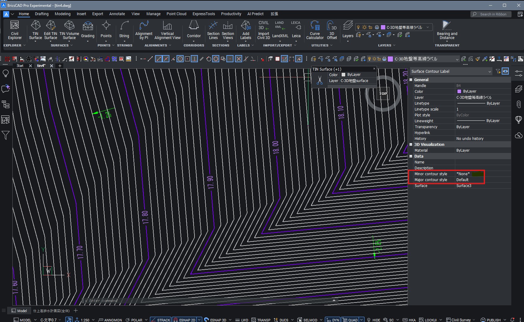

Has anyone else noticed a change in Surface Contour Label behavior in V27.1.05?
In V25.2.10 and V26.2.08, I could select "None" for Minor contour style to hide the minor contour labels completely, while keeping Major contour style set to "Default" to display the major contour elevations.

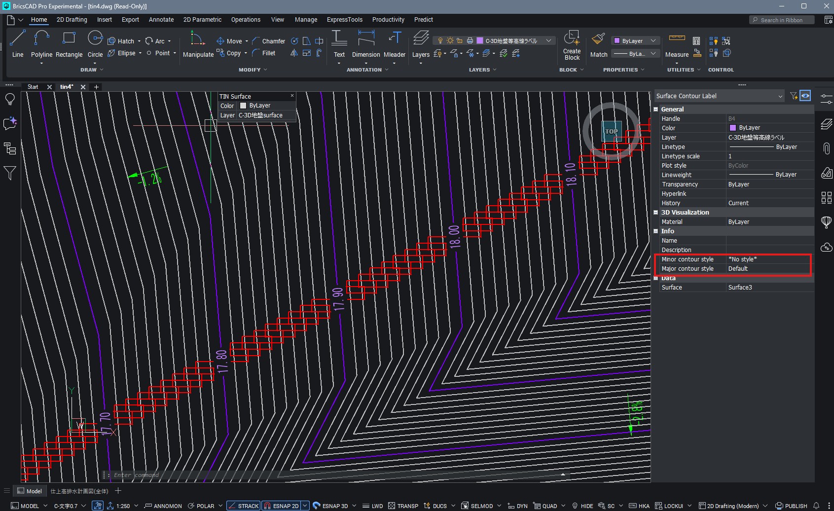

In V27.1.05, "None" is no longer available. Selecting "No style" leaves numerous empty red rectangular boxes at the minor contour label positions, as shown in the attached comparison screenshots.
I'd like to keep the major contour elevation labels visible without displaying any text or boxes for the minor contours. The red boxes make the drawing difficult to read.

Comparison screenshots: Ver26.2.08.jpg and Ver27.1.05.jpg
V27.1.05
V26.2.08
