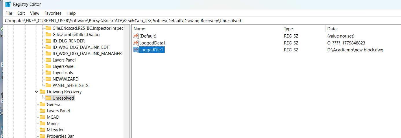

Is there a way to turn off the Drawing Recovery pop-up? It is more of a nuisance than a help. I would think that clicking yes and opening the list, then closing, would clear whatever flag triggers the pop-up, but it does not seem to.
Comments
  • Hi Martin,
    Right-click on the folder(s) in the Drawing Recovery Panel and select Remove to remove the folder from the panel without recovering the files. This will clear the contents of the panel, and the recovery message will no longer show up next time you start BricsCAD.
