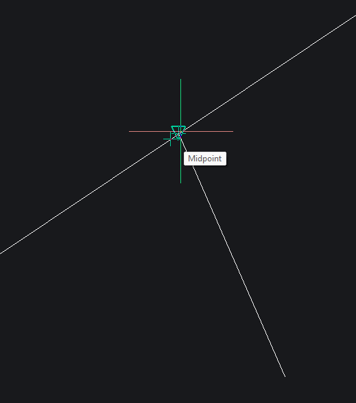

Snap to centre of line, change from triangle
Hi, is it possible to change snap to centre of line from trinagle to something else

  • Could you elaborate on that? No idea what you are asking.
  • Please see above, change triangle into something else, maybe a square

    Clear!
    SnapMarkerThickness, SnapMarkerColor and SnapMarkerSize can be changed but I am not aware of possibilities to change the shape.
    Just curious, why do you want that?

    I'm using for the first time and have come from AutoCAD background, and for several subtle reasons, the flow is just not the same as in AutoCAD, although BricsCAD is very good as well
    So far changed some settings as per notes I made below for own reference, but still not the same. I adjusted ATTRACTIONDISTANCE to a large value, but in reality when drafting you get stuck and have to zoom in to release the attraction … on this is there a setting to what you can attract to such as end points and mid points for lines, centre only for circle

  • It is easy to get lost here, we agree on that :-) Personally I tend to keep values equal, so the same value for:
    aperture gripsize pickbox attractiondistance (snapmarkersize)
    Setting apbox to 1 helps me a lot.
