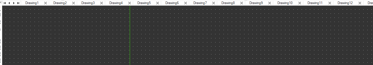

Created some dummy-files. I start by open, in this case, Drawing1 as kind of a original. Then in Explorer I select let say 40 other dwgs and just drag them in to Bricscad. Look likes below (but with real names) hopefully in a filename order.
Then select Drawing1 and now I want to check next drawing in the tab list, in this case it is Drawing2. This by do a missing command. After that I want to go back, by a missing command, maybe do some work, or not. Then "forward" again, check if something was missed, if not close that drawing. And repeating this as long as there is open drawings.

May Work, thanks!
But some strange happens. Start up, create 15 empty drawing by Qnew. Drawing15 is in focus. Now "you can move forwards and backwards using Ctrl + Tab and Ctrl + Shift + Tab" works. But if by mouse Drawing5 is selected and then continue by keyboard, there will be random(?) drawings selected?
