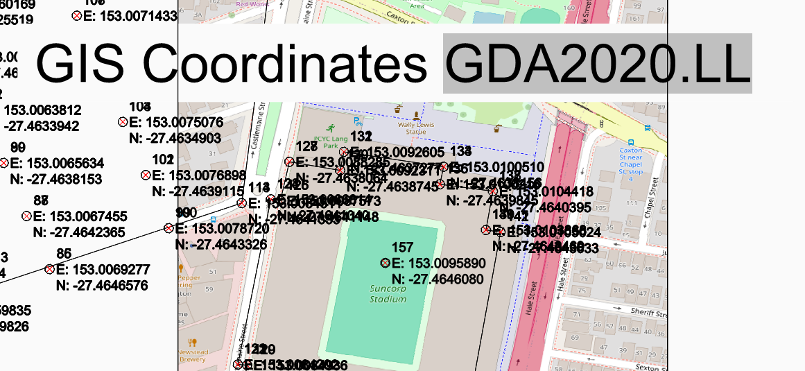

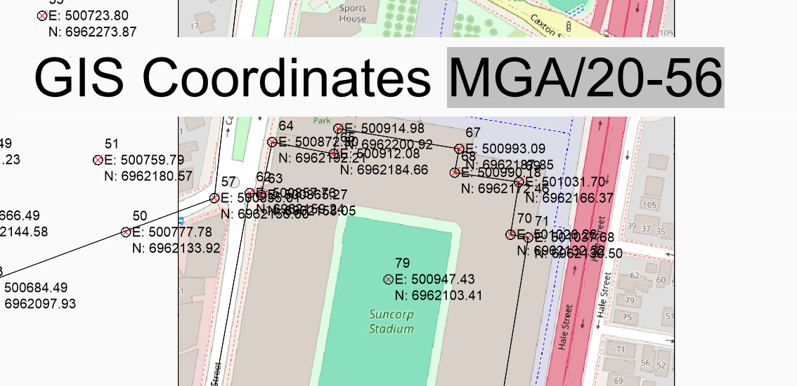

I'm trialling latest version and perhaps only reason to upgrade for me is the GISEXPORT option to save as shp or kml files
However I'm having trouble getting this to work.
All my jobs are true GDA2020 Zone 55 and I only work in eastings and northings.
I set the GIS coordinates as GDA2020 EPS:7844 that I gather is the only option for use here from the drop down box.
But the exported file sits either way off over NZ or up north across Indonesia.

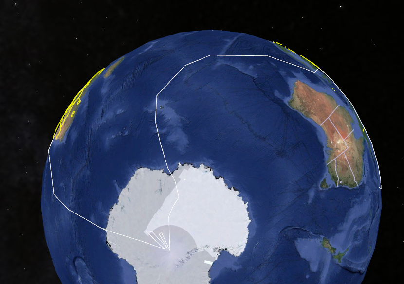

  • Yes Tasmania
    Interesting use GDA94 and it works okay
    But we work GDA2020 and whilst only about 1.6 difference its different
    One I created spun a spiders web around the globe when opened in Google Earth
    I haven't tried shp export. That's no use to send to average person in the street.

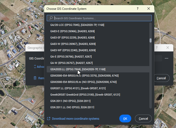

  • Did you guys get the GDA2020 coordinate system files? I need the same but not sure where to look. Any help will be appreciated.
    Thanks mate
  • Perhaps ask Lyubov Osina where it's at.
  • GDA2020 (EPSG:7844) coordinate system is availiable in the default coordinate system list of GEOGRAPHICLOCATION command. CSMAP contains additional GDA2020 coordinate systems, see "About CSMAP" part of this Help article: https://help.bricsys.com/en-us/document/command-reference/g/geographiclocation-command?version=V25&id=165079079473

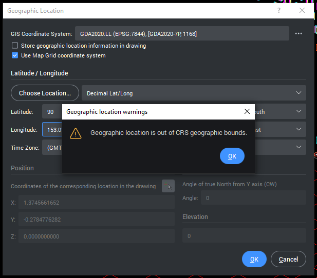

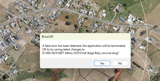

  • Hi Lyubov,
    I am not sure of what I am doing hence my silly question.
    I did find the one you mentioned in the GIS Coordinate System dropdown. But I am not able to progress due to lack of knowledge. I keep getting this message.
    Here are the details of what I have to set for my model
    Geodetic Datum used : GDA2020
    Height Refernce : Australian Height Datum (AHD): RL34.904
    Grid Datum : Australian Geodetic Datum (AGD): PM52464
    Project Base Point :
    N/S: 6951503191.0
    E/W: 504671485.4
    Elev: -340.0
    Rotation: 9.38 deg
    Other information that you might need is
    Project is located in Toowoomba, Queensland, Australia
    Closest city location as per GIS is Brisbane, Australia
    Timezone is Brisbane, Australia
    Could you please try these values and educate me on how do I apply these to the dialog box above.
    Hope this is enough information for you to help me
