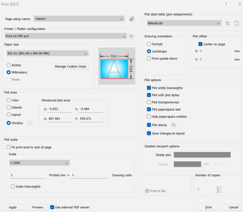

    All I can say is we have been doing this method for over 20 years and alway works. Two things may be causing it to not work, our tittle block in a layout for say A2 as requested if we measured the title sheet it would be close to 594x420 units. So longest side is 594 when using "DI" distance 2 points, if you set title block to 0.594x0.420 can see problems. The tile block is plotted at a scale of 1:1 The viewport is scaled to suit, ie 1:250.
    just a side note in the plot parameters we had a A1 sheet as our normal title block, at true size 841x594, if when plotting the we set the scale to 1=2 then it would plot a A3 sheet. We used a window setting picking the two diagonal corners.
