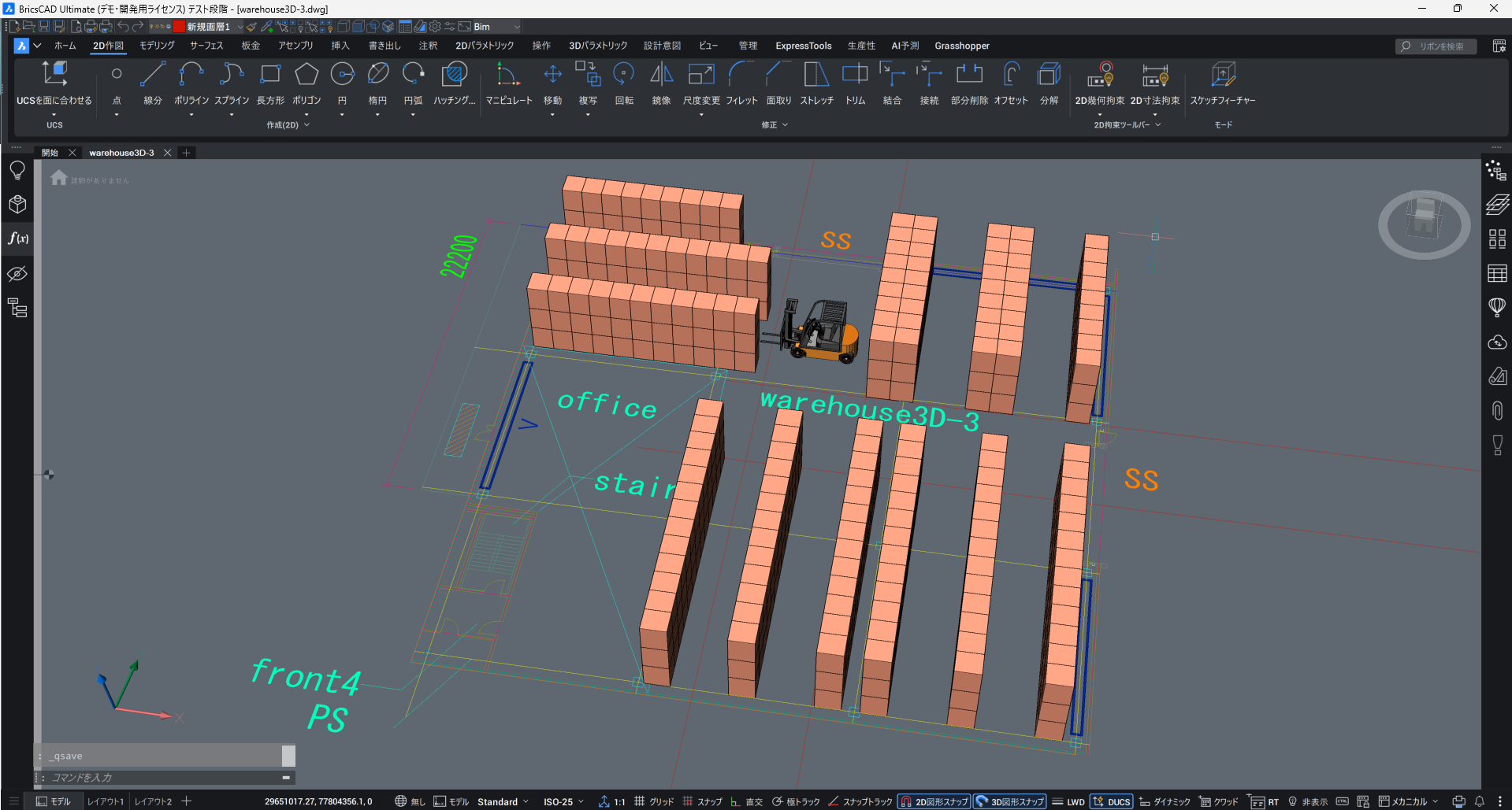

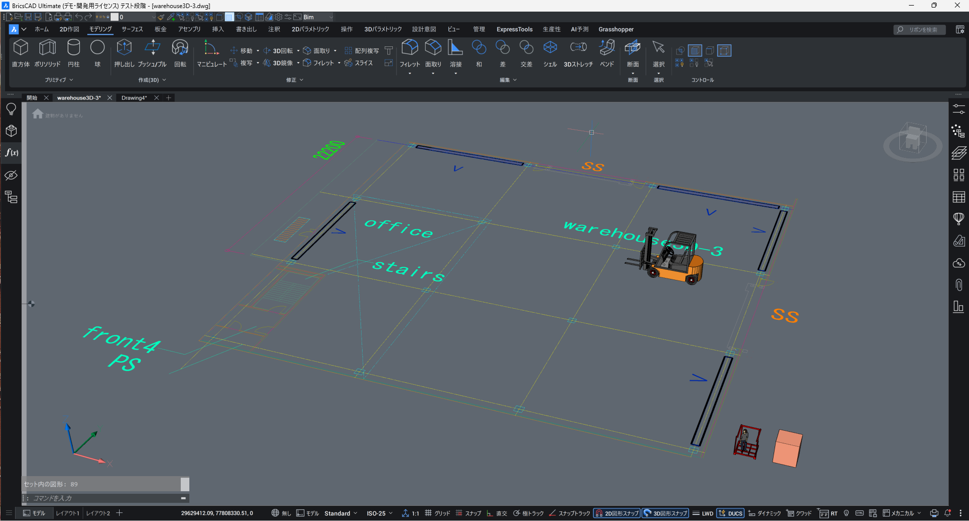

Note, there’s attached drawing, with a forklift already
0 -

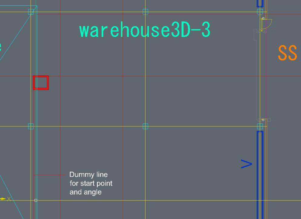

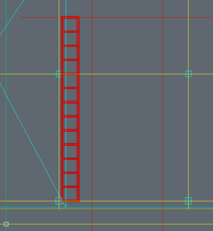

Missed the dwg attached, thanks, so had a look a couple of ideas, if you look at the racks for me the patterns, in 3d view
top left 1,1,1
right 2,2,1
bottom 1,1,2+,1,1
The numbers meaning a single row, a dbl row, a 2+ dbl row with a gap. then see if they fit within the boundary area.
Will have a think about it. playing with dwg made a rectang that could be arrayed/copied it matches the 1350x1200. But its not 3D. Maybe start with pick 1st corner top left pick 2nd point for distance and angle. Can then draw what fits within correctly for that distance.
Ok so start points need to be in some areas offset to allow for structural components, ie a dummy line. The red pline is the rack.
So before I go further and add more columns of racks is that ok juliette ?
