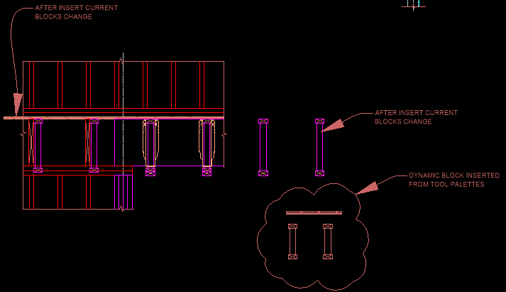

When i add a dynamic block to drawing from the tool palette and there are current blocks the drawing the existing blocks change , some resize some stretch or rotate and i have to go find all instances of blocks to make sure they are correct. This does not occur with all my dynamic blocks and not seem to follow a pattern i can see, sometimes i add a block and it's ok.
Any suggestions would be welcome, thanks

  • sorry for got to add the image
