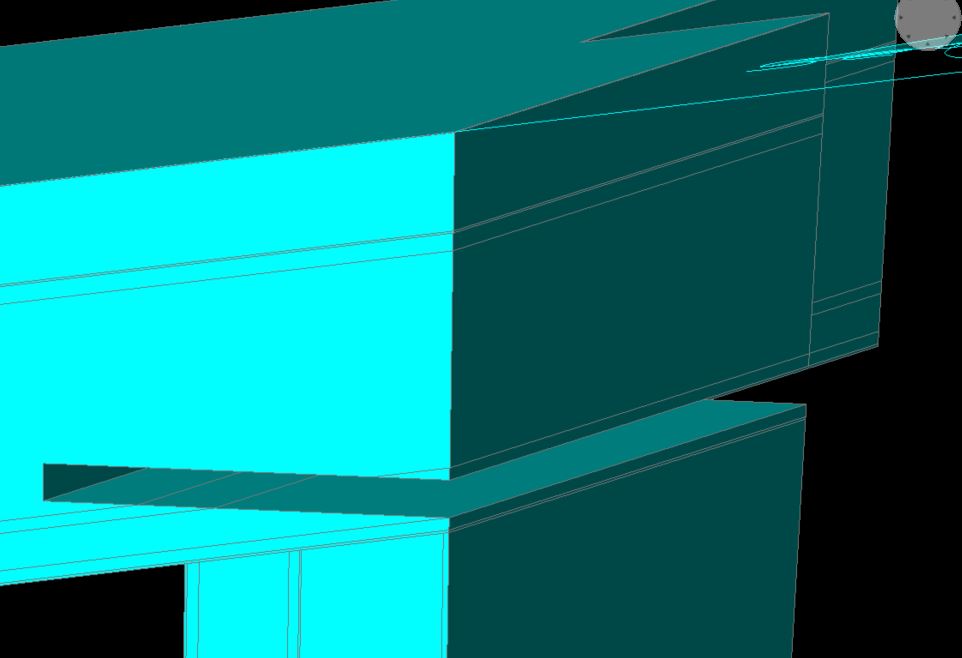

In SR91962 (2019, on v19.2.07) I wrote:
"What is a recommended method for adjusting Compositions' Plies at say a wall/roof slab junction, where the angle between the slabs is not 90o?
It's recommended to use Push Pull but that operates perp to the selected face, with result like 300-8.jpg attached.
DMEXTRUDE>Direction>2 points works but is laborious and makes only a parallel-edged push-back, not of the full non-parallel section of the solid, leaving un-push-backed wedges at the end(s)."

    That's the standard, rectilinear case, where push-pulling plies individually, and propagating them, works as intended.
    My first Q was about non-rectilinear situations, which are definitely not uncommon - for example a sloping roof plane meeting a wall. My attached pic shows what happens - or used to happen until fixed in v21.2.02? and I was seeking confirmation it now works for that common non-rectilinear case.
