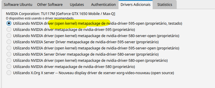

There's a good chance it's the driver. I've had a lot of trouble with drivers. I don't use SUSE; I use Kubuntu 26.04 XOM X11. In my case, I had to use the NVIDIA driver (open kernel) metapackage. The non-open kernel driver caused constant crashes. Try looking at other drivers or, in this case, a Ubuntu-based distro.

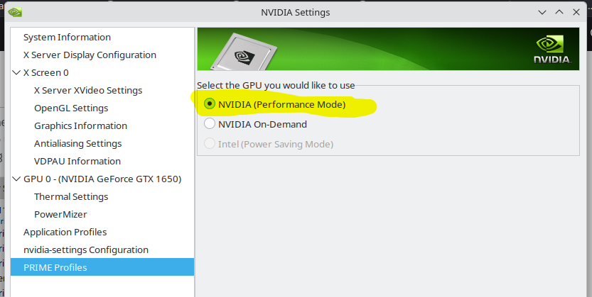

Another thing to check is in the control panel to see if it's in performance mode.
