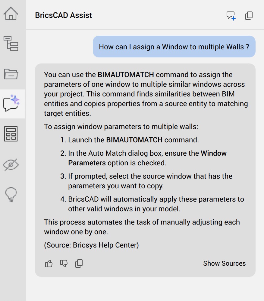

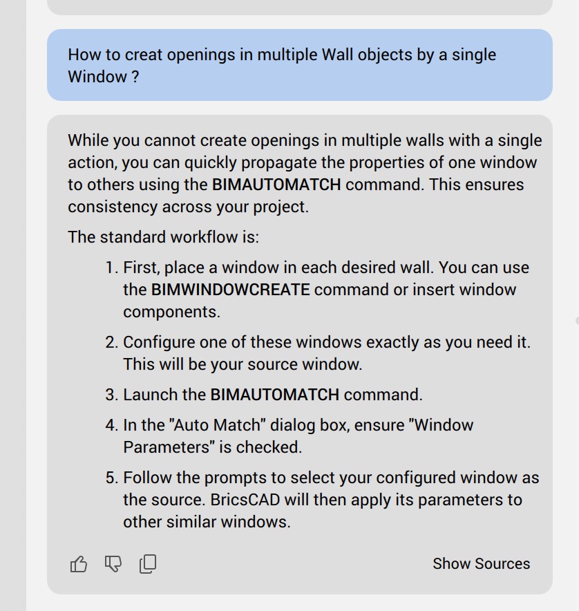

    Hmmh, ….
    Bricscad AI Assist may not really understand my prompt ….

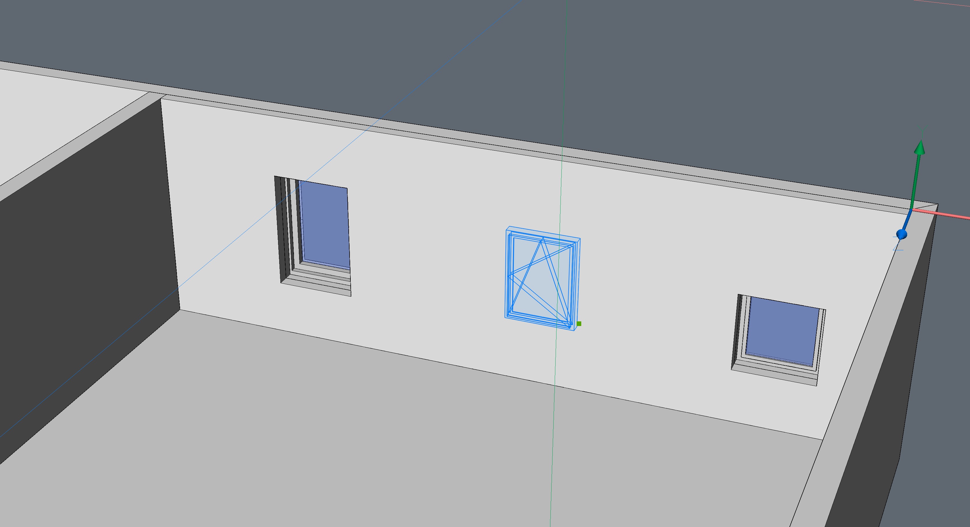

    Seems to work somehow …. if you …. select both Walls before you select and add a Window from the Library.
    It does not seem to really work with the advanced Windows (?), it cuts through both Walls but the Window seems to revert to a standard Window (?)
