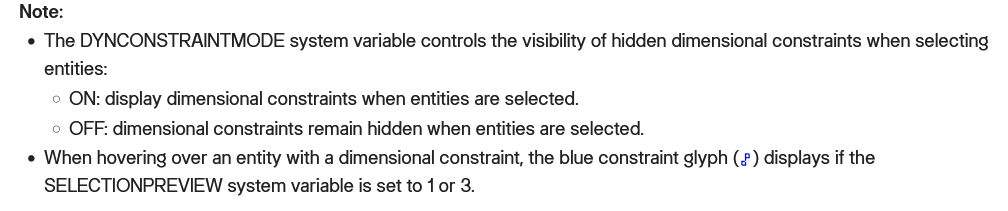

This is new to me. This is in a drawing I just received. Is shows up on things like structural beam linework elements (the beam symbols have been exploded) and circles representing the handles at sinks. Can anyone tell me what it is? Is there a way to turn it off, or better yet, remove it completely? I'm seeing thins on V26 latest.
Comments
Martin,
From Bricscad help.
0 -

Thanks. I miss the days when things like this were findable in the documentation.
