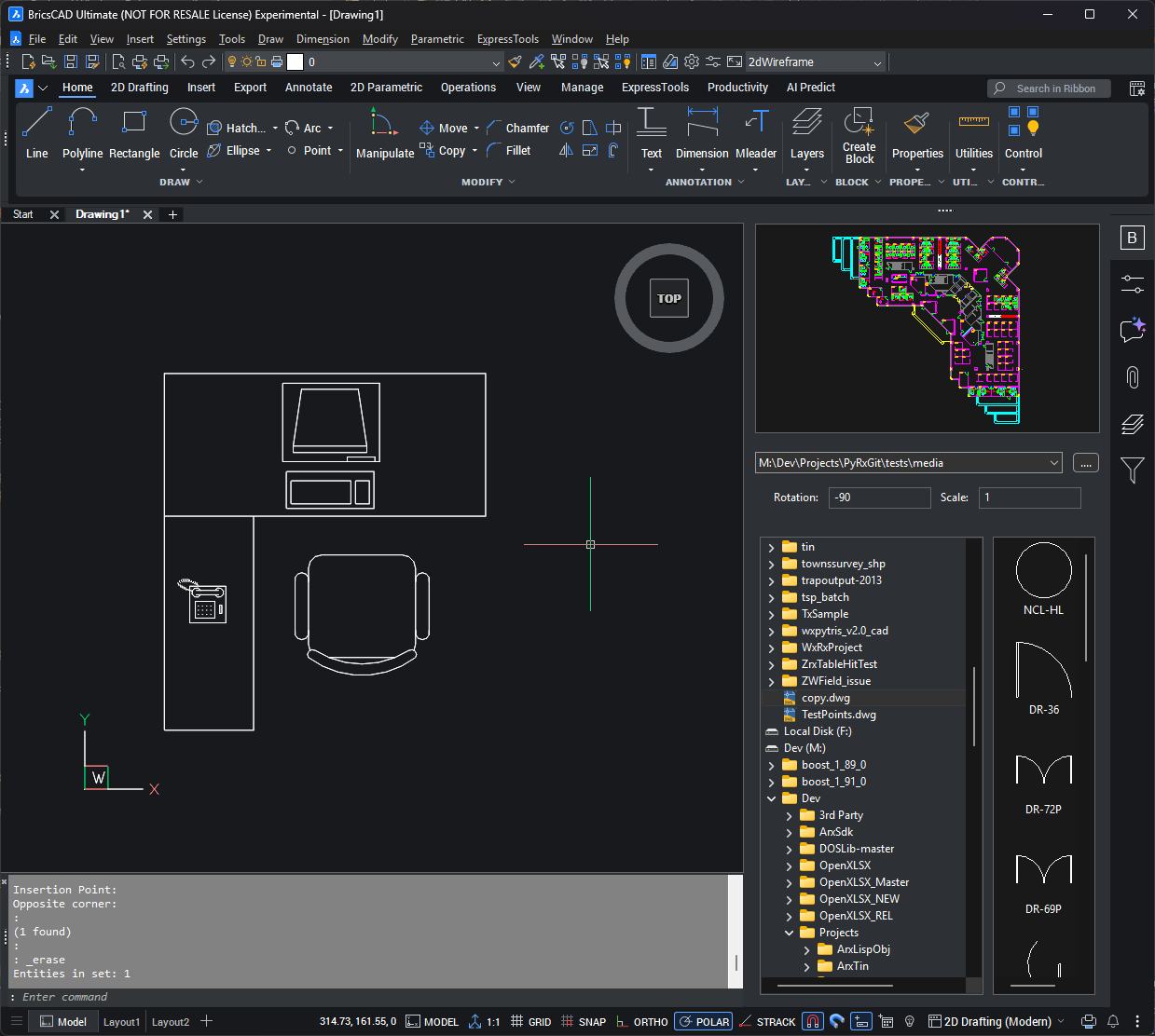

Minimalist block manager?
The goal is, maybe...
  • add your favorite folders
  • right click on the dropdown to clear the favorites
  • drag from the main preview to insert the whole drawing
  • drag from the list control to insert a block

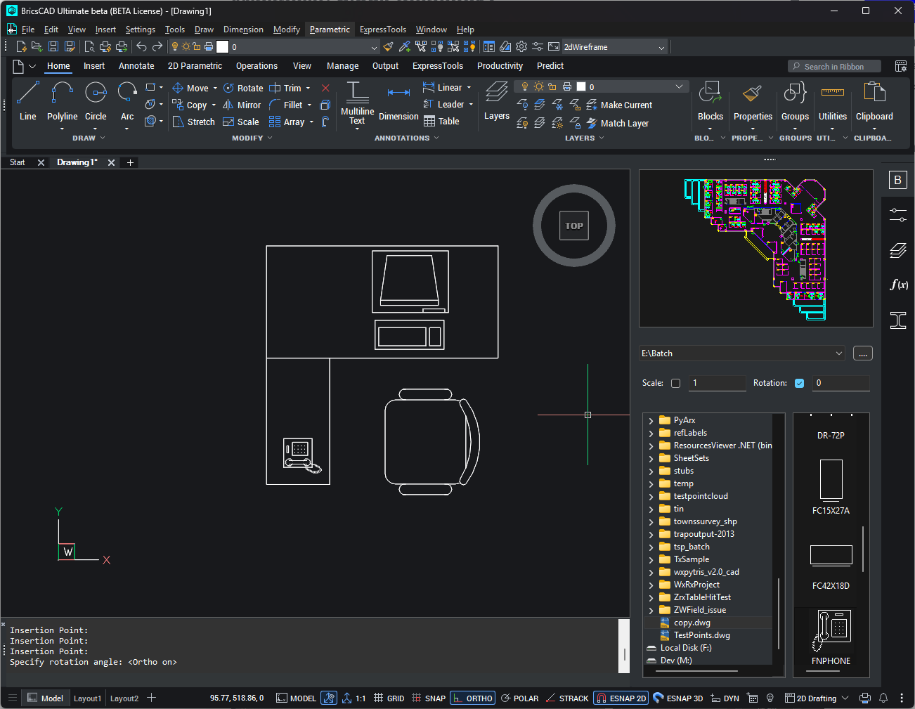

Do I still need to add scale, rotation? I don’t want to.
Edit: it needed it
Comments

    Proof of concept (V25, V26, V27Beta)
    • appload BrxBlockManXX.brx
    • type blockman at the prompt
    • select a drawing from the directory control
    • double click or drag a block from the List control to the current drawing
    • double click the main preview to insert the whole drawing
    • click the open folder button to add your favorite folder(s)
    • use the dropdown to navigate to a favorite folder
    • right click on a dwg to open it
    edit, moved to https://github.com/CEXT-Dan/BrxBlockMan
