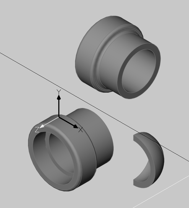

Once I had the base s

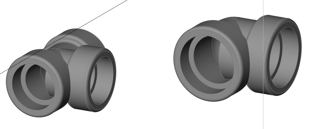

olid, (See Base solid.jpg) 1 leg of an elbow, I then copied that solid, rotated it then made a corner infill to complete the 90 degree elbow. If I try and trim the end of the base solid to 45 degrees so the internal bore isn't obstructed the physical body stops responding to the table changes.
I then made another file where I copied the base and rotated it 180 degrees to make a tee.
You can see the perpendicular leg protruding inside the fitting. For now it will have to do, the critical elements are all there, socket diameter and depth, distance from 1 leg centreline to base of perpendicular socket.

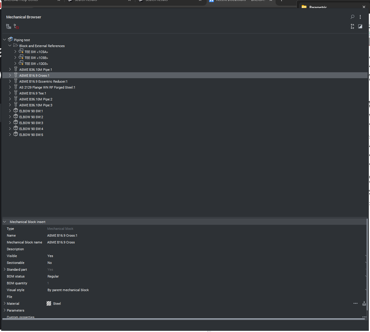

HOWEVER. While both blocks are created from the same base file and wblocked out, the elbows show in the BOM and the Mechanical browser, the tees don't, sort of.

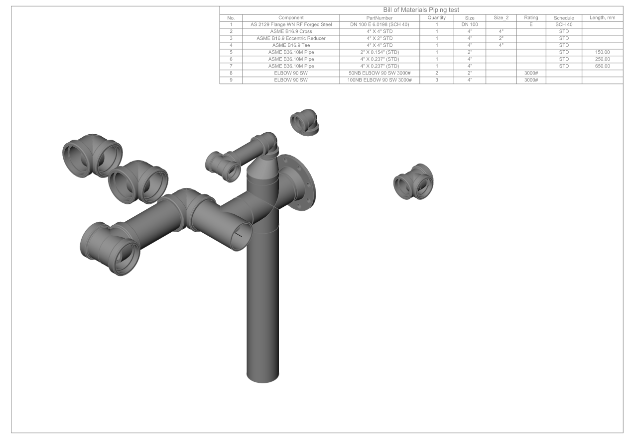

Drawing 1 (Piping test), started with some BricsCAD components, just seeing what was in the library. Then added my elbow and tee, the elbow shows in the BOM and browser, the tee doesn't show in the BOM, in the browser they show under "Block and External references", not their own entry like the elbows. See Piping test drawing and browser screen shots.

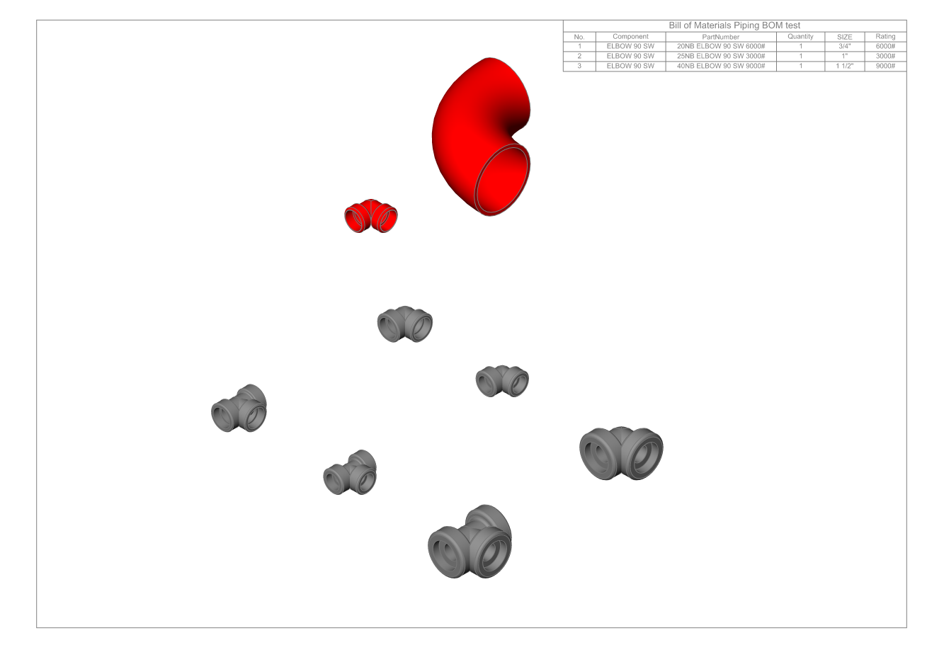

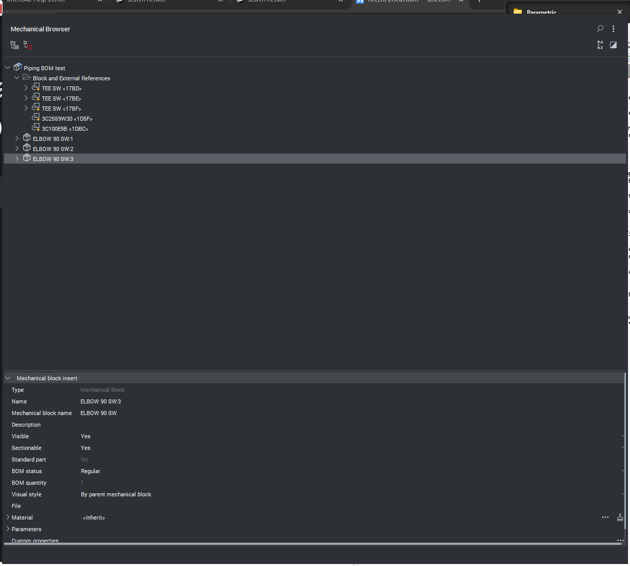

Drawing 2 (Piping BOM test, saved from drawing 1 and deleted and purged the BricsCAD native components. Added a couple of my old librry blocks in red, non parametric. Again the elbow shows in the BOM but not the other blocks. Again in the browser they show under "Block and External references", not their own entry like the elbows. See Piping BOM test drawing and browser screen shots.

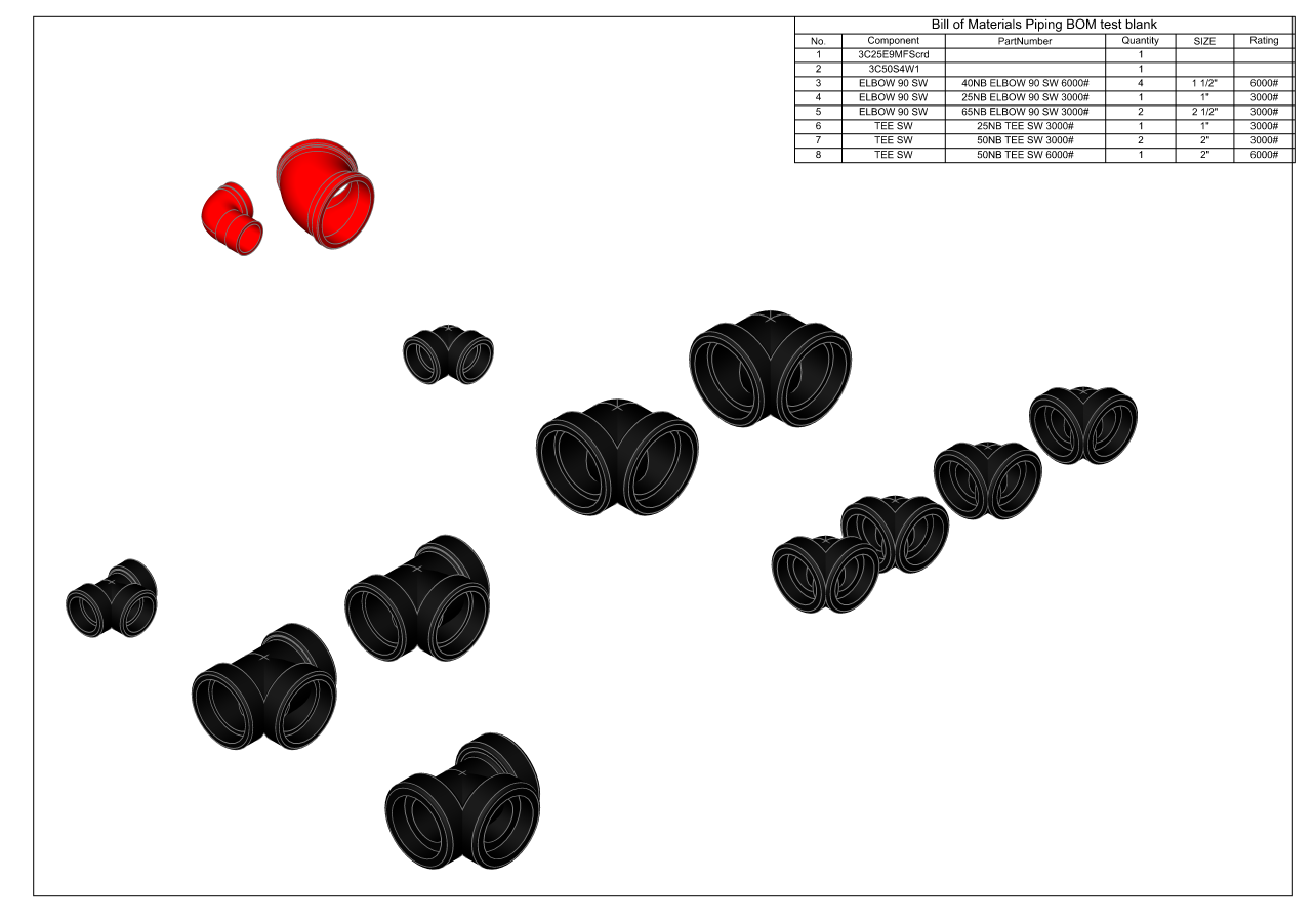

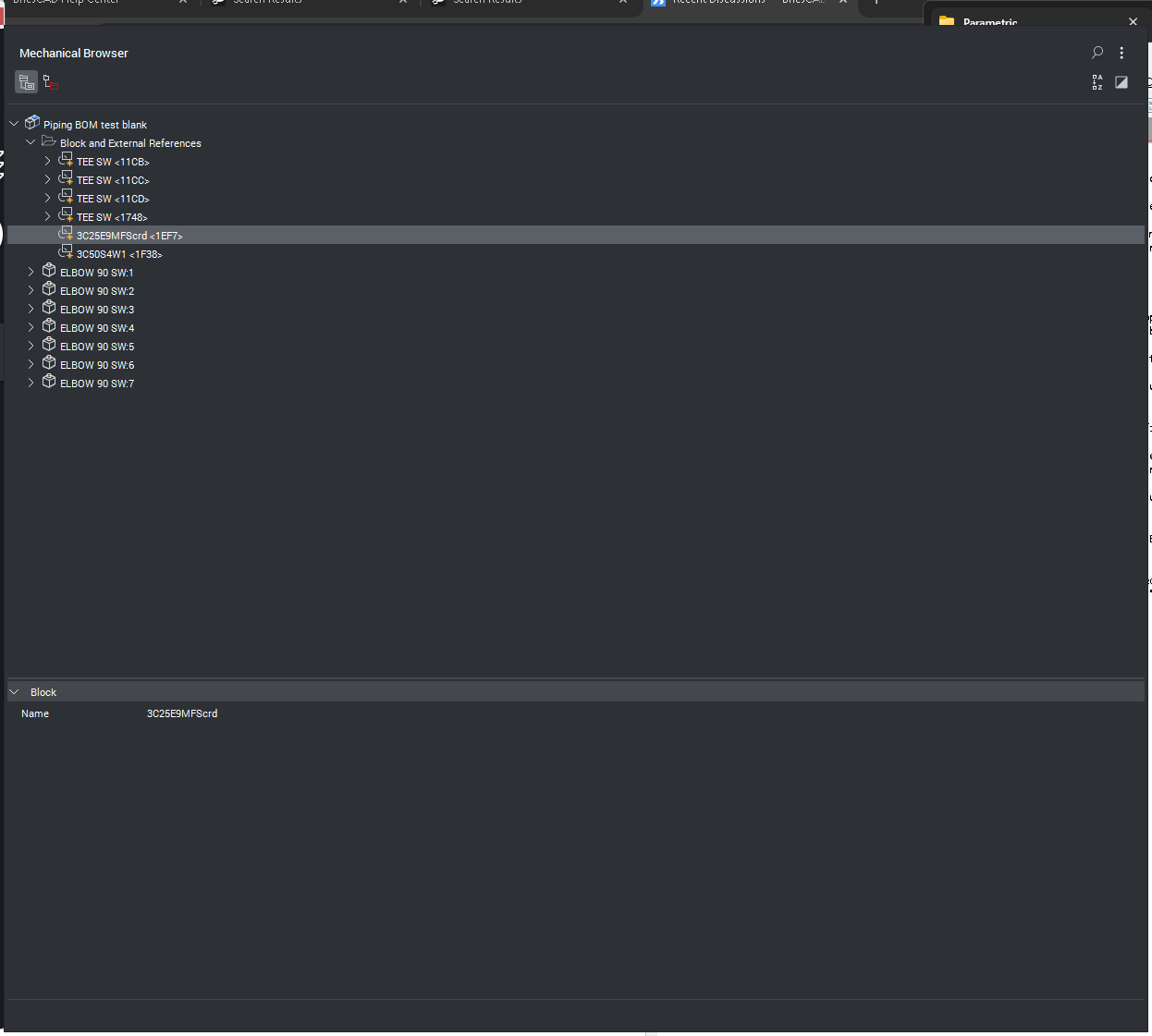

Drawing 3 (Piping BOM test blank), Started with a new blank drawing. Inserted my parametric elbow and tee and a couple of non parametric blocks, in red. While the elbows have there own lines in the browser and the tees and others are under "Block and External references" again, they all show in the BOM table. See Piping BOM test blank drawing and browser screen shots.
  1. Why do some blocks show in the browser as their own line and others under "Block and External references".
  2. Why do those under "Block and External references" show in the BOM table in one drawing and not others.

  • Have solved the above issues.
    Firstly the elbow block wblocked as a "Mechanical block" while the tee wblocked as a standard block, I have no idea why. Hence one having it's own line in the browser (The mechanical block) while the other showed under "Block and External references".
    Two things to do:
    Firstly when in the block editor run BMMECH command, this converts the block to a mechanical block.
    Secondly when in the block editor go to the mechanical browser bar, select the block and set "Standard part" to yes.
    Now they function as expected.
