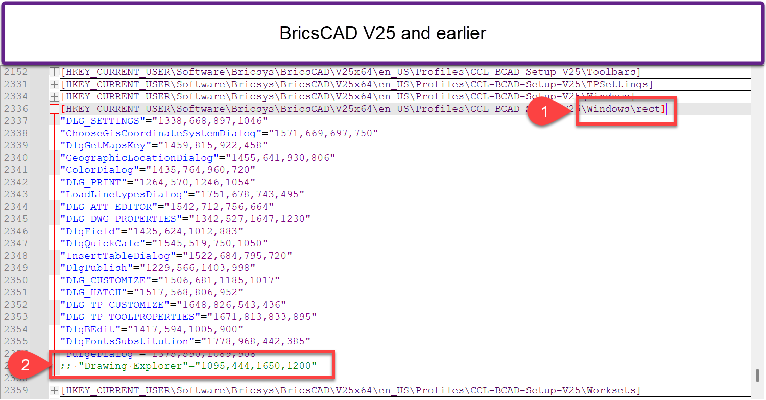

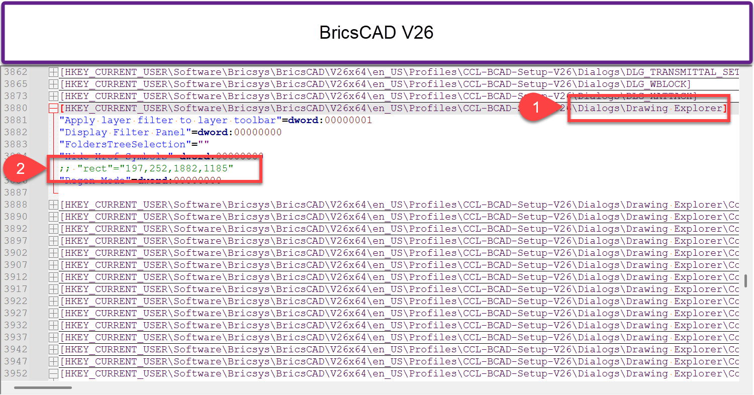

  • Sounds like the explorer dialogue is opening off screen. This can happen when you have a second screen that you disconnect from.
    If you search the forum I've previously posted a LISP tool that will reset the window position for you.
