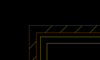

  • Hatched wall,
    I tried HPGAPTOL worked in some situations.
    Else need to select objects. I used layiso to isolate the layers then select entities inner and outer line work no plines.
    If working at full scale hatch can not detect a pick point.
    Still waiting for a non working sample.
