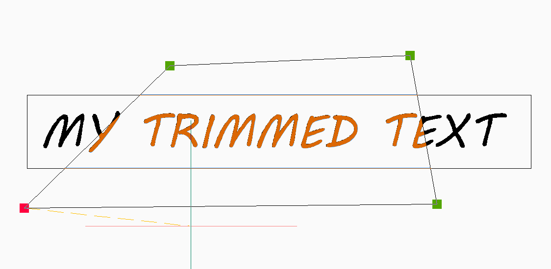

If you wanted to preserve the text and the ability to edit it, then you could creating a BLOCK with the text entity inside. Having done this you can use XCLIP to crop the text to just what you want to show.
You can quickly create a block by selecting the text then going CTRL + C to COPYCLIP, then CTRL + SHIFT + V to PASTEBLOCK it back in a block.
