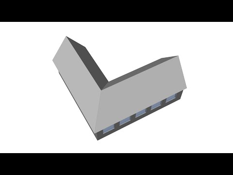

  • Is there a specific intended method for drawing roofs, etc, or just use shapes?
  • I didn't do any roofs so far,
    but I think the recommended way in Bricscad is by using Polysolid.
    So I think that also applies to Shape.
    That was 2 years ago but I didn't heard of any different workflow so far :
    https://www.youtube.com/watch?v=lN_62EQbGqQ
  • We saw this video at the conference at the end of last year. It uses the manipulator tool and then creates a shell from the shape. It looks really easy. The video is about 22 minutes and the actual modeling begins at about 7 mins

  • I can't imagine why anyone would make a roof as a dumb polysolid, when no one would do walls like that. A roof has layers and structure just like walls, columns etc - why should we not model it? Not being critical - just baffled. 'Other BIMs' proudly have automated creation of such dumb lumps - makes me shudder!
  • edited January 2018
    I thought that is why you use a Polysolid.
    That you can apply a Composition.
    A Roof Composition, just like a Slab Composition.
    And do the Ply Connections just how the rest of Bricscad BIM works.
    No ?
