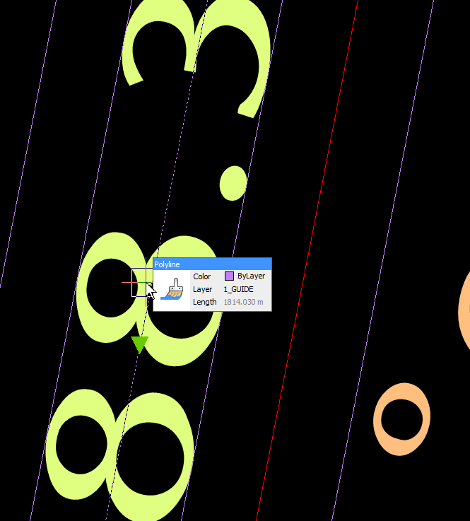

This is common to Ver 18 & 25
I see when I mouse over a node it is difficult to actually select such to drag the node about.
I would assume the pick box should grab that node once the box overlaps any part of the node. Doesn't seem to work like that though.
Have looked at a few settings but can't get it to improve what I would call 'its magnetic attraction' if you get my drift.
I have changed my mouse batteries, cleaned the mouse to isolate any issue associated with such. And tried another mouse - 2 others
help is much appreciated thanks

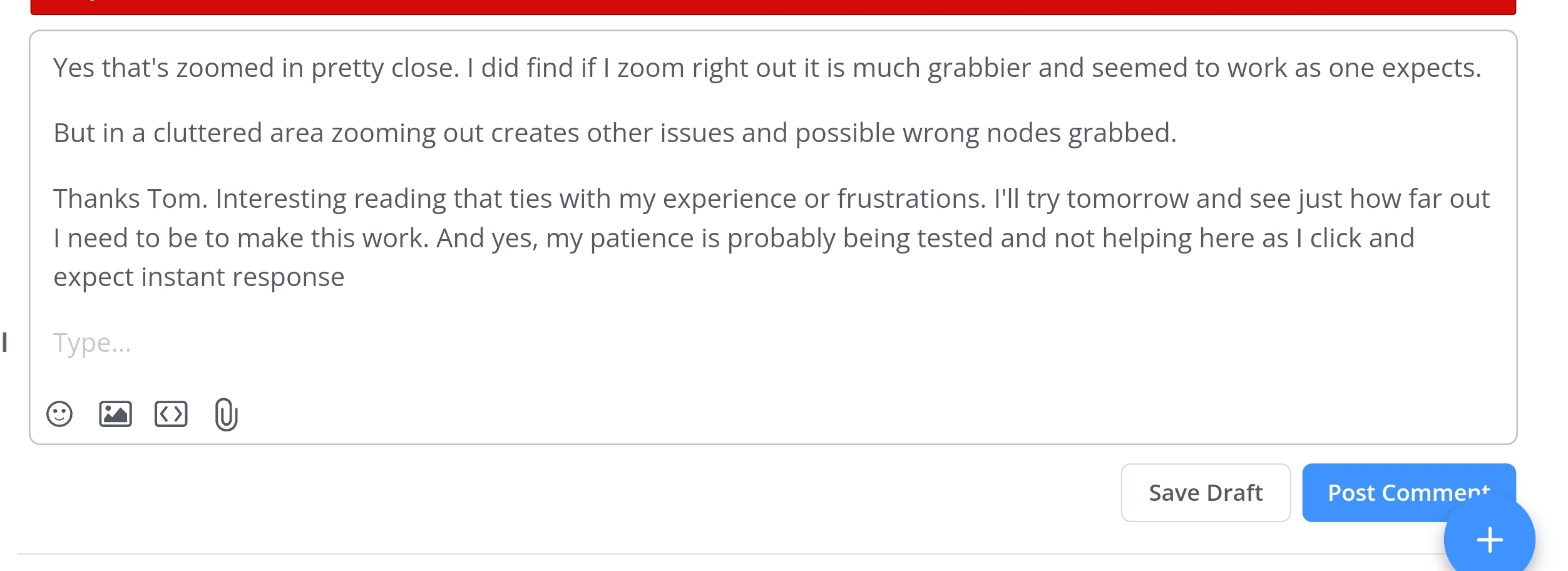

    Thanks folks. I wrote a reply and posted but it showed garbage.
    I grabbed a screenshot when I tried to edit and post that

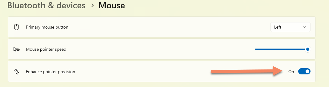

  • Update: I think I found the culprit
    Mouse settings has and option 'enhanced pointer precision'"
    I stumbled on that when Windows updated and wiped my mouse and once I got it going it worked abysmally slow.
    Looked at settings and saw the option.
    I clicked it ON and it definitely works as I was accustomed to and grabbed the node very quickly and easily
  • Good to be 'pointed' to the mouse cursor - source of some frustration, I realise, incl sometimes obscure tooltips etc, can be improved, incl downloaded transparent or outline designs.
  • It sure was a relief
    Such and instant and dramatic change

    BTW the screenshot of the first post shows a grip, not an end snap. There’s ‘GripSize’ which can be increased, lets say to size 8, that may make it easier to select.
  • The important thing is that grip size and snap icon size are both a lot smaller than the mouse pointer box. Snap uncertainty comes when you think the grip or snap is within the mouse pointer's box when you click, but it's only nearby. With a smaller pointer box, they seem to coincide but often don't. As long as the grip or snap are inside the pointer box, all is well.

    Tom I played with the Pickbox (12 now 20) and Gripsize (4 now 10) and it certainly improved things but when zoomed out it looks rather odd with the highlighted nodes consuming a lot of screen space. Will play more.
    But with said settings I zoomed in and as seen, held the mouse over the text. I expected it would select the text and the polyline, But only way to get the text is to zoom in and select it between the linework.
