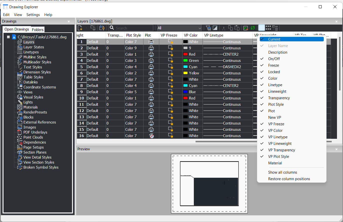

    You said:"I double-click inside of the viewport and then set the layers just the way I want them." Do you use VP overrides or common properties? You need to use columns named like VP Freeze, VP Color, etc. to set viewport overrides. If these columns are not displayed, press right mouse button on any column header and choose which properties you want to display.

  • Lyubov Osina, I started off just trying to use the On/Off, but then after watching the various YouTube videos and searching the BricsCAD help articles, I switched to using the VP Freeze column.
