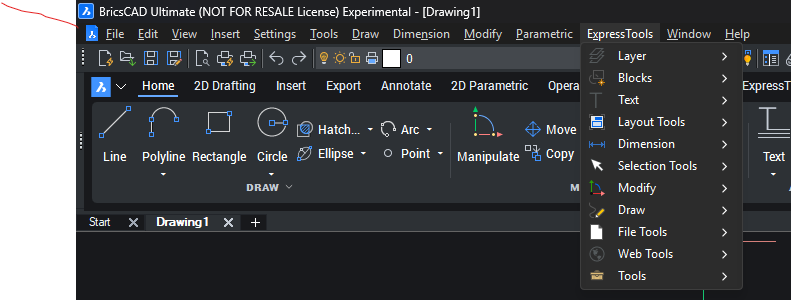

Some, flickering (very slight) when hovering over the bar. I’ll post a BRX if anyone is interested
Comments
  • Could you elaborate a bit?

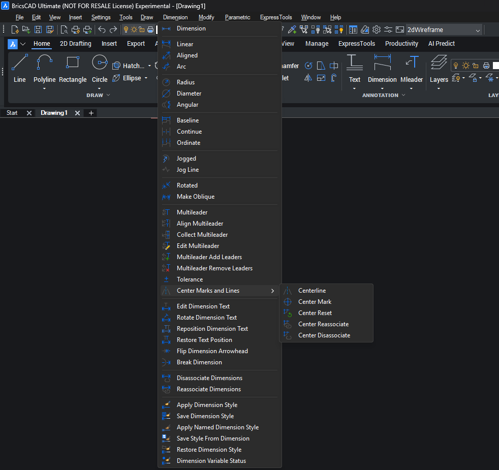

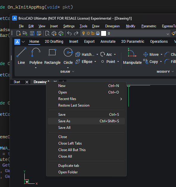

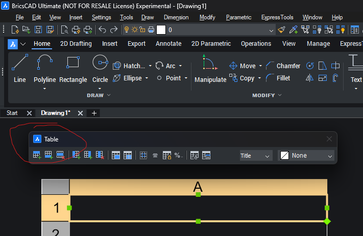

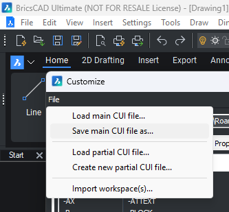

  • I hooked into the menubar and forced it to draw darkmode via Win32 calls. All of the menus throughout BricsCAD draw dark. I may have spoken too soon though, the right click menu for stuff like OSNAPs is wonky.
  • Its_Alive
    edited 8:45AM
    Might not be for everyone.
    - I repaint a new dark menu bar over top of the existing bar, anytime that rect is invalidated, there’s a slight flicker
    - Right click menus in the editor widow are drawn white, there’s a flicker the first hit, subsequent menu calls are cached.
    - Dynamic input sometimes invalidates the whole window, causing a repaint, so there’s a flicker
    How to use, find your version inside the Zip file, drag the BRX onto the editor or use the appload command, select autoload as needed. I’ll try to refine it over time

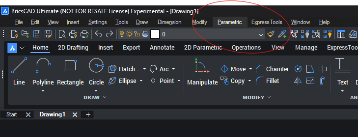

    edit: posted a better version

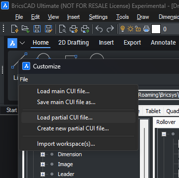

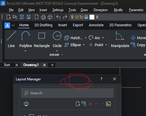

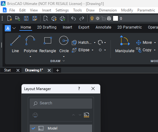

  • Modal Dialogs get a dark title bar.
    old
    new

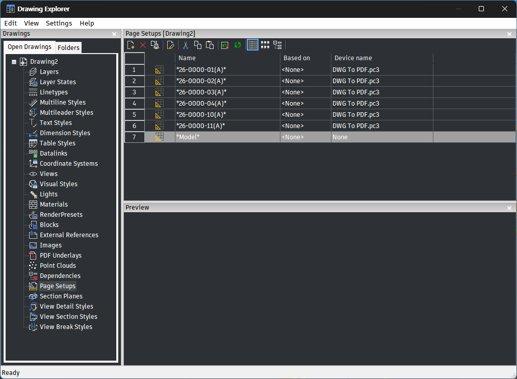

    The main frame and menu are not QT, I think to remain compatible with ObjectARX and palettes. I’ll probably post the code on GitHub once I’m done playing.
    I’m actually taking inspiration from wxWidgets 3.3.X, where they implemented a nice dark mode. I suspect eventually Bricsys might use, I.e. instead of rewriting the drawing explorer from scratch.
    BTW, here’s a sample BRX using wxWidgets with BRX. github.com/CEXT-Dan/WxArx
    For the record, I’m not using wx here, just Win32 SubclassProc

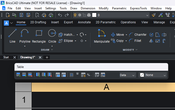

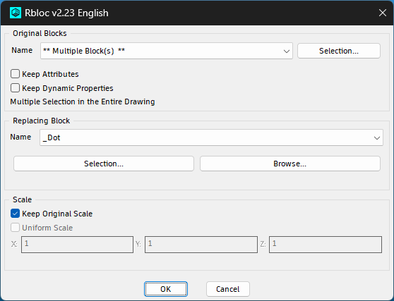

    Latest change, if the dialog does not have an ICON, attempt to add one
    old
    new
